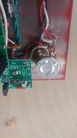

3.  I can barely turn my Crack up at all before it's far too loud, what do I do?
Disconnect the white wire at the pot that originated at the left RCA jack.  Install a 75K resistor between this wire and where it connected on the pot.
Repeat this step for the red wire coming from the right RCA jack.
Attach and solder one 33K resistor between each outer pair of lugs on each level of the volume pot and the ground lugs on the pot.
Resistor wattage is unimportant, 1/10 Watt or greater will work nicely.
See the photo at the end of this post for how these resistors are attached to the pot.
