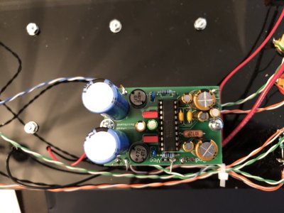

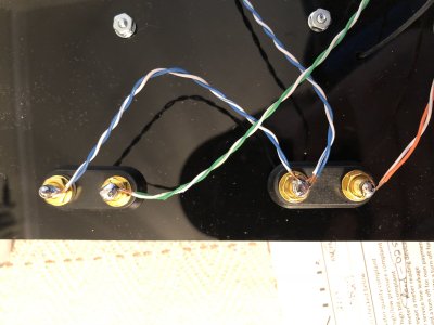

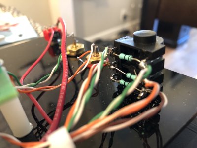

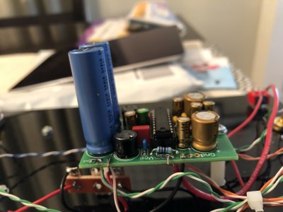

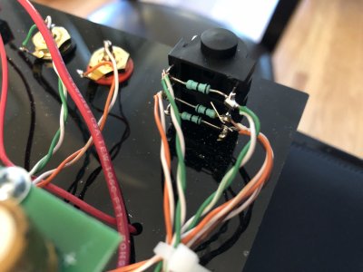

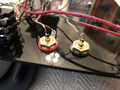

I just finished my Quicksand and have apparently screwed the pooch somewhere along the way.
I installed the batteries, plugged my iPhone X into the input jacks, turned it all the way up, started music, then plugged in headphones. No sound. Toggled the Quicksand's power switch on and off a few times, no sound. Unplugged the headphones, plugged in speakers. No sound.

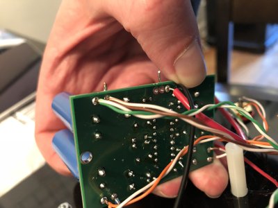

I've attached photos of the build, although photos of the underside of the board are difficult to get. Let me know if there's an area I should get clearer photos of.

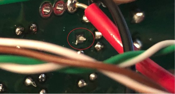

There's at least one unsoldered joint down there.

So embarrassing. That did it.
