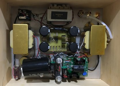

Are you using the stock coupling caps?
~100mV isn't particularly concerning but still probably something to measure again in 6-12 months.

Are you using the stock coupling caps?  ~100mV isn't particularly concerning but still probably something to measure again in 6-12 months.
PB - Thanks for answering my question.  See the attached photo to answer your question.
