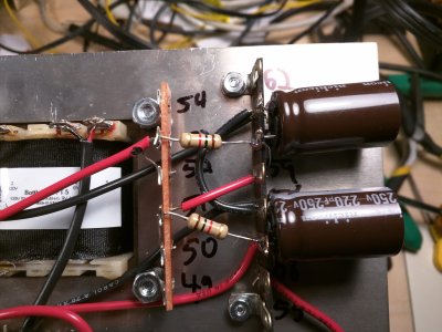

I've attached pictures of the assembled unit for reference.
Are there any obvious errors that I have made?  Additional measurements I can take to help narrow down the problem?

Hi Cory. Looking at your first photo, from what I can tell it appears that the wire from the transformer winding has become detached from transformer terminal 7. This would certainly explain the lack of voltage.

That was it!
I soldered the transformer wire back to the output tab, and now it makes sweet, beautiful music!
Thanks so much for the help, I NEVER would have spotted that!
