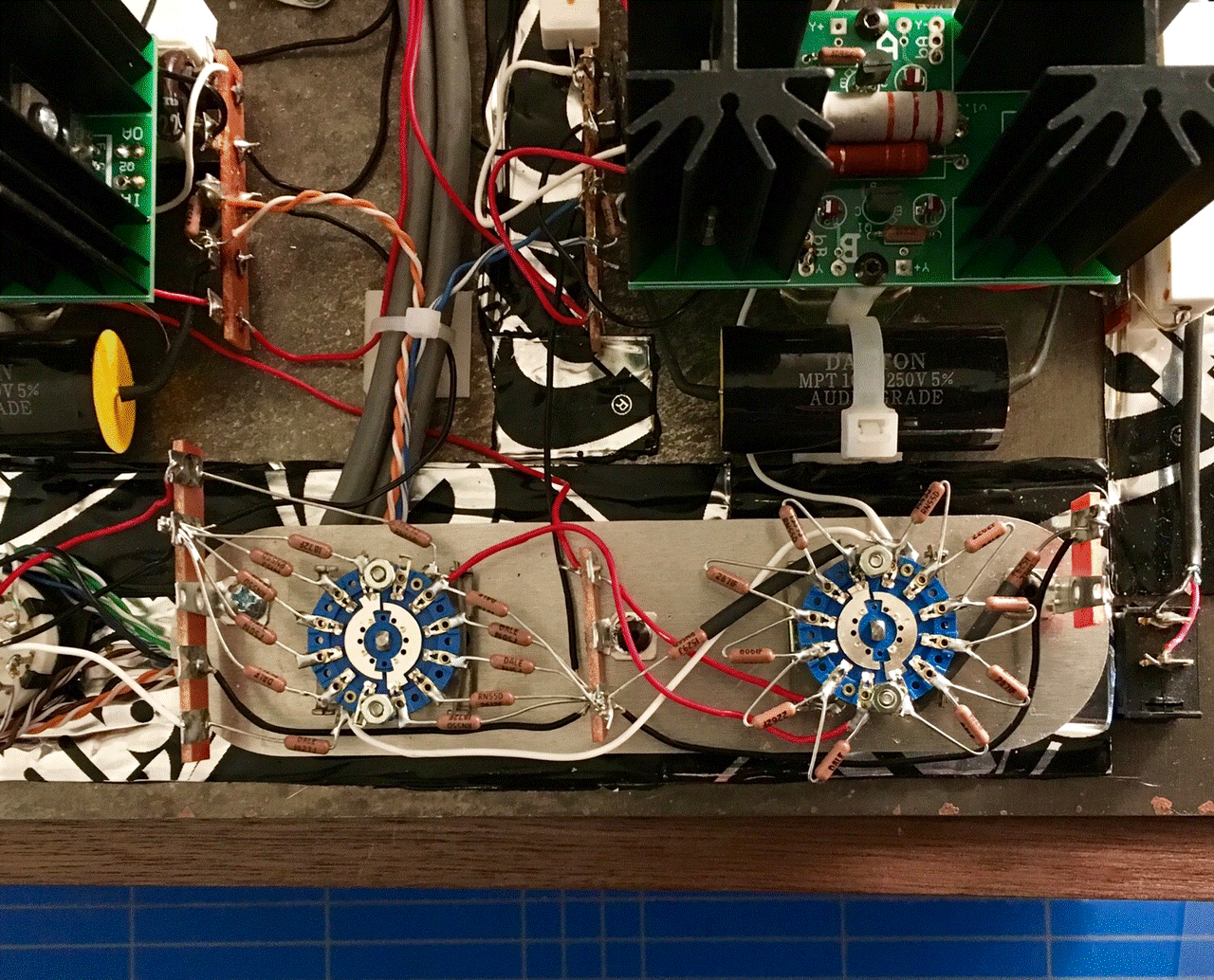

I don't have a BeePre, but if you've done the wiring correctly,then this should not be the case. I suggest to check your wiring again. You may also want to post a picture of your wiring here.

I checked all the wiring and it looks ok. Here is a picture:
(https://image.ibb.co/jW5BJ5/Be_Quiet_oltmb.gif)

The lowest level position does not mute, it attenuates -52.5 dB. The way that the attenuator is wired precludes the inclusion of a mute (i.e. signal shorted to ground) setting. If you are finding that the entire range of the volume control is too high, you are on the right track of either lowering the output level of your source or using a larger value attenuator between the BeePre and the amp.
If the listening level range is OK and you just want a mute you can always switch the source selector to a source setting that is not playing. That's what I do in our listening room.
